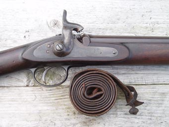

Most old military longarms had sling swivels, but their original leather slings are usually long gone. Replica firearms are rarely sold with slings, but making a sling that fits you and your musket or rifle is pretty simple. This article shows you how to do it.
This sling in this article is a copy of the Norwegian military sling that was used on the old Norwegian kammerlader rifles and the Remington rolling block rifles. You don't need any buckles or other metal objects; the sling is made entirely of leather. The sling which serves as an example is used as an example is made for an original P-1856 Enfield rifle musket, and has the following measurements:
  • 3 mm (.118") thick
  • 135 cm (53") long
  • 30-35 mm (1.38") wide
The Enfield sling pictured here was supposed to be a target sling and not a carrying sling, and that's why it is as long as 135 cm. I bought the sling from an acquaintance which is a shoemaker by profession, and it cost me 60 Norwegian crowns. The leather was uncoloured, but leather is easily coloured with any leather dye. You can get the dyes in a number of different colours. The colour I chose was dark brown.
Remember, if you pre-order a leather sling you must measure the sling swivels on the weapon you are going to use it for. The length must also be considered. On my Enfield there is a rather long distance between the two sling swivels, and that calls for a long sling. For most other firearms the sling could have been shorter.
