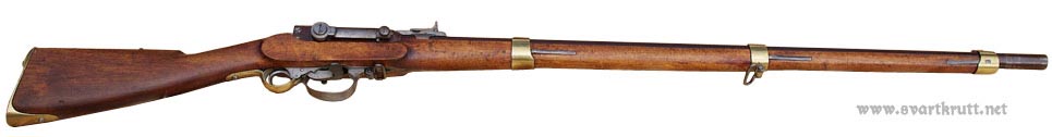

18 bore (16,63mm) kammerlader rifle Model 1842.

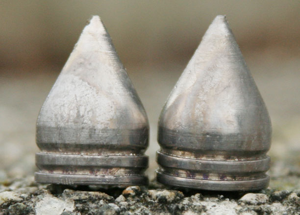

Until 1855, the general-issue ammunition was paper cartridges that contained roundball and an 84-grain black powder charge. Selected sharpshooters had successfully been using a conical ball since 1849. In 1855 it was decided to issue conical ammunition to all troops. The same year a new conical ball was adopted for the kammerlader and Norwegian pillar-breech rifles.

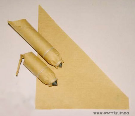

The paper cartridges were used to speed up loading. The cylindrical part of the bullet was wrapped in paper that was fastened to the bullet with wool or linen thread. The remaining paper behind the bullet formed the powder container. After the cartridge was filled with 96 grains of Fg black powder the casing was closed by folding the paper into a tail. Lastly, the bullet end was dipped in a molten mix of sheep’s tallow and beeswax.
In 1861 a new paper cartridge was adopted. The new model was based on French and British cartridges and is quite similar to the British .577 Enfield cartridge.
See videos on how to make the different models of paper cartridge for the kammerlader: roundball cartridges, conical ball cartridge Model 1855 and 1857 and conical ball cartridge Model 1861.
