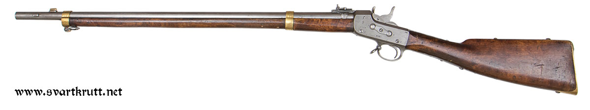

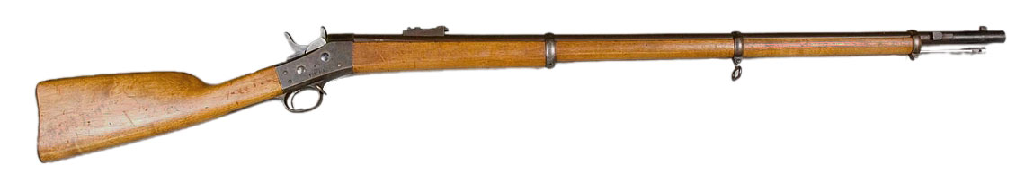

Norwegian 12mm Remington rolling block rifle made at Kongsberg. Note the muzzle protector.

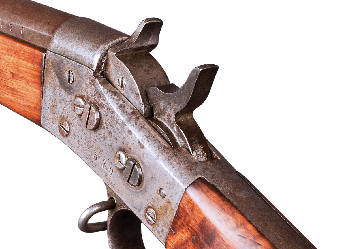

Cocked action.
Cocked action.

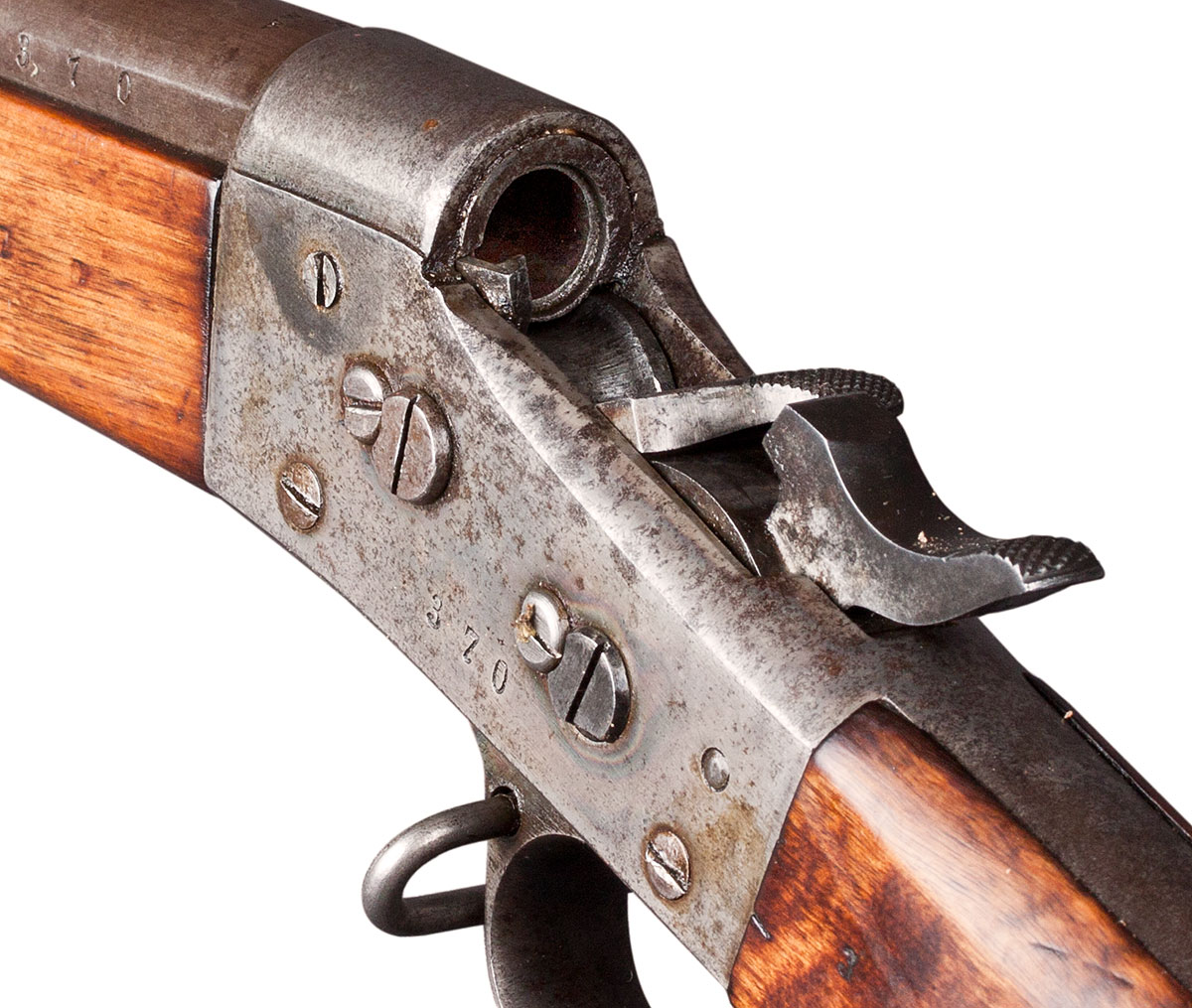

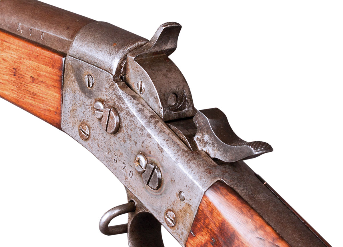

Cocked action with breech block opened.

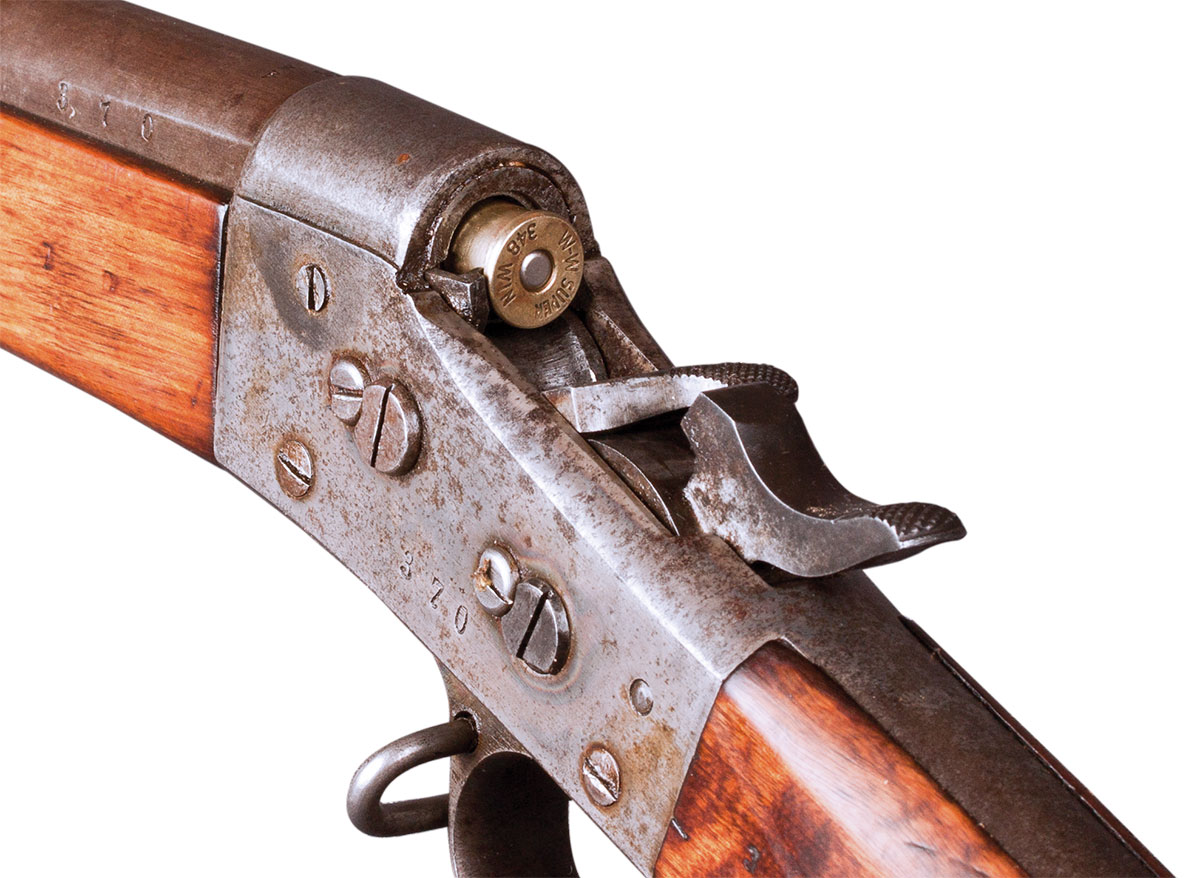

Cartridge inserted in chamber.
Norway and Sweden adopted the Remington rolling block rifle as a general-issue service rifle in 1867. The calibre was nominal 4 decimal lines. In modern terms the actual calibre was 12.17mm (.48"), but after Norway started using the metric system in 1879 the rifle was designated the '12mm Remington rifle'.
The Remington rolling block rifle was developed at the E. Remington & Sons factory in the US during the mid-1860s. A single-shot rifle, the soldier had to load a single cartridge for each shot. To load he cocked the hammer, opened the breech block, inserted a round into the chamber, closed the breech block and pulled the trigger. The rifle was sturdy, easy to operate, had a high rate of fire and was relatively accurate. About 45 countries and states adopted the Remington rolling block as a service rifle, including the US, Denmark, Spain, Mexico, Argentine, France and Belgium. The Danish rifle's calibre was 11mm.
Norwegian and Swedish Remington rolling block rifles
In Norway, the Remington rifles were made at Kongsberg Våpenfabrikk (weapons factory). The military Norwegian and Swedish rifles differ in some respects – and there are also several different patterns of the Swedish rifles. The most noticeable difference between the Norwegians and the Swedish is that the rear sight is different and that the Norwegians had a brass butt plate, while the Swedish had steel butt plates. The Kongsberg rifles are marked with an easily recognisable crowned K. Norway also purchased 6000 finished rifles from Husqvarna in Sweden.

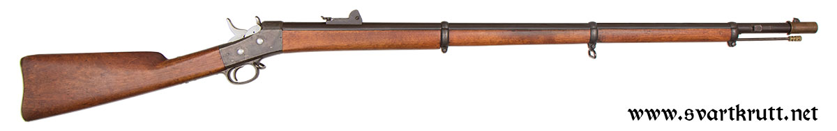

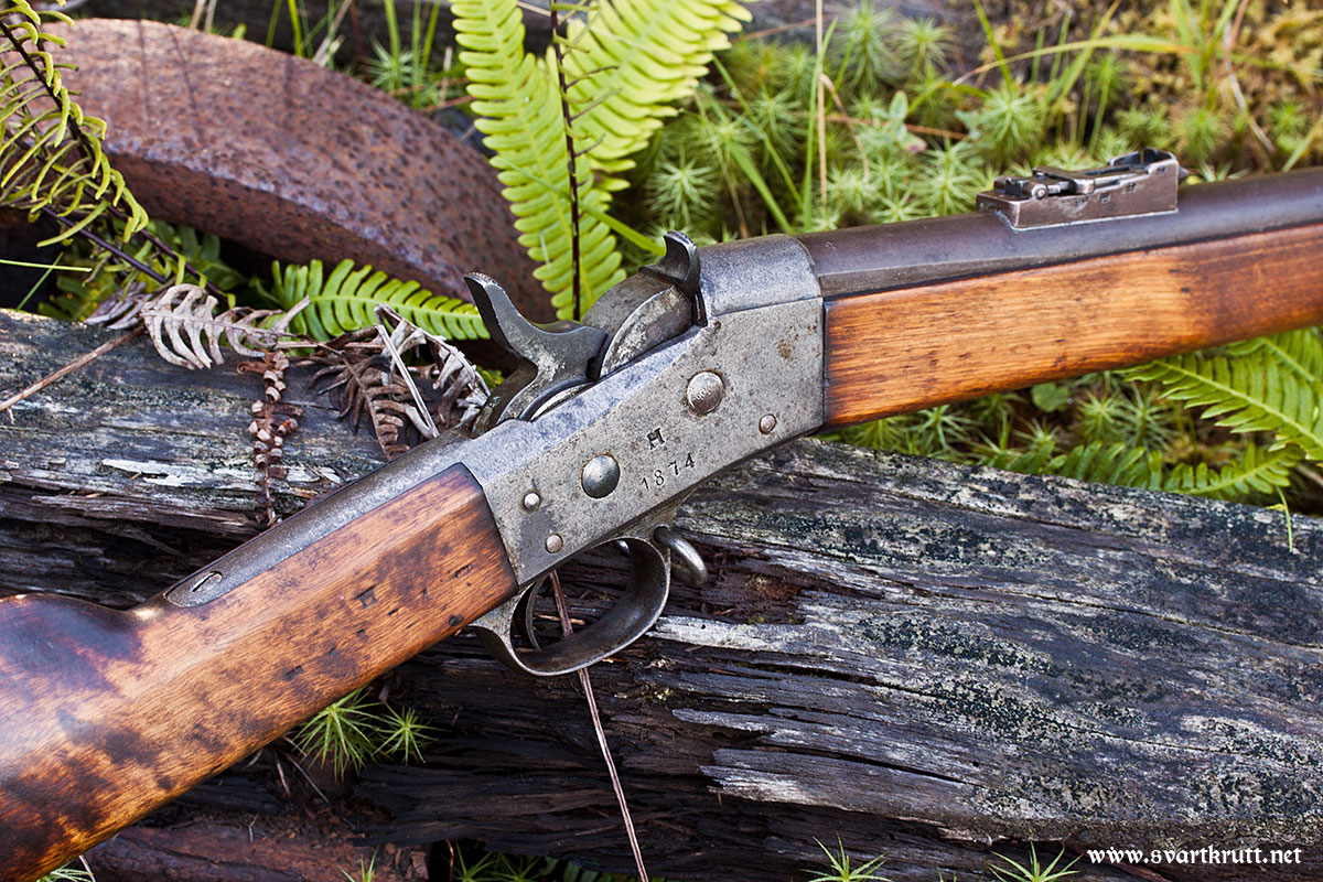

Swedish 12mm Remington rolling block rifle Model 1867-68 made at Husqvarna in 1874.
The factory-new Swedish rifles are available in the following five main models:
  • Model 1867 made by Remington in the US
  • Model 1867 made in Sweden with action from the Remington factory
  • Model 1867 with the arc sight (bueklaffsikte)
  • Model 1867-68 with the new «ramtrappsikte» adopted in 1868
  • Model 1867-74 with altered buttstock and metal plate for locking the bolts

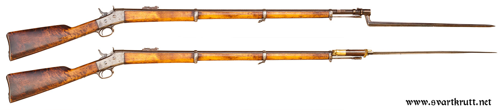

While the Norwegian army issued rifles with sword bayonets, the Swedish army issued socket bayonets. The Swedish navy however, issued a sword bayonet. It is worth noticing that all Swedish rifles have a sword bayonet lug.
Swedish army Remington rifle Model 1867-68 with socket bayonet (above). The Swedish navy issued a sword bayonet (below), but all Swedish rifle have sword bayonet lugs.

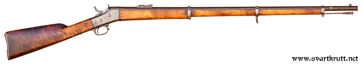

Swedish Remington rifle Model 1867-74.

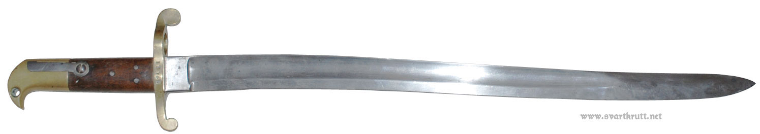

Bayonet

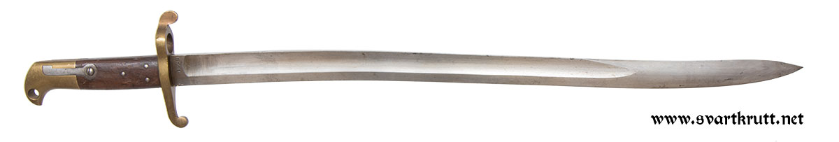

Norwegian Remington rolling block rifles were delivered with a sword bayonet. The Swedish army used socket bayonets, while the Swedish Navy used sword bayonet slightly shorter compared to the Norwegian.
Sword bayonet Model 1860 for the Norwegian Remington Model 1867.

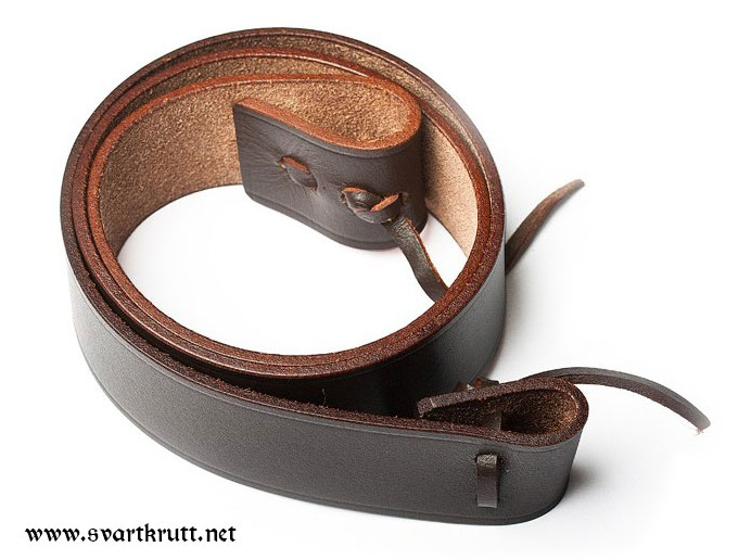

Sling
The sling had no metal buckles and was identical to the sling used on the kammerlader. This article shows how to make your own sling. The sling was 910 mm long and 36 mm wide.
Replica of a Remington sling.

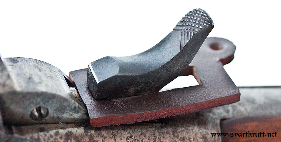

The stopper was a device made of leather that was slipped over the hammer to prevent damage to the mechanism from dry firing. It measured 50 × 25 mm, with a cut rectangle in the middle.
The stopper.
The stopper.

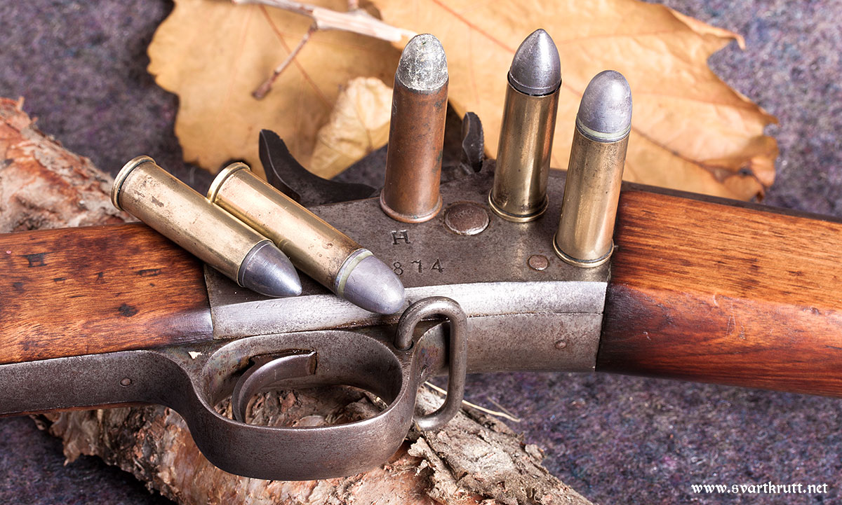

The cartridges

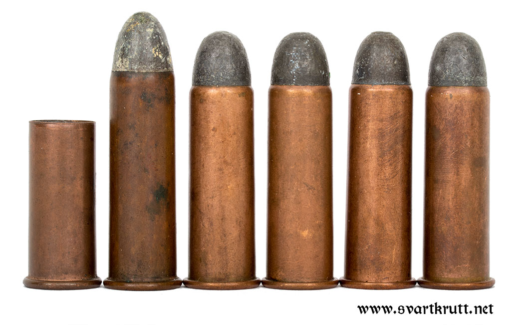

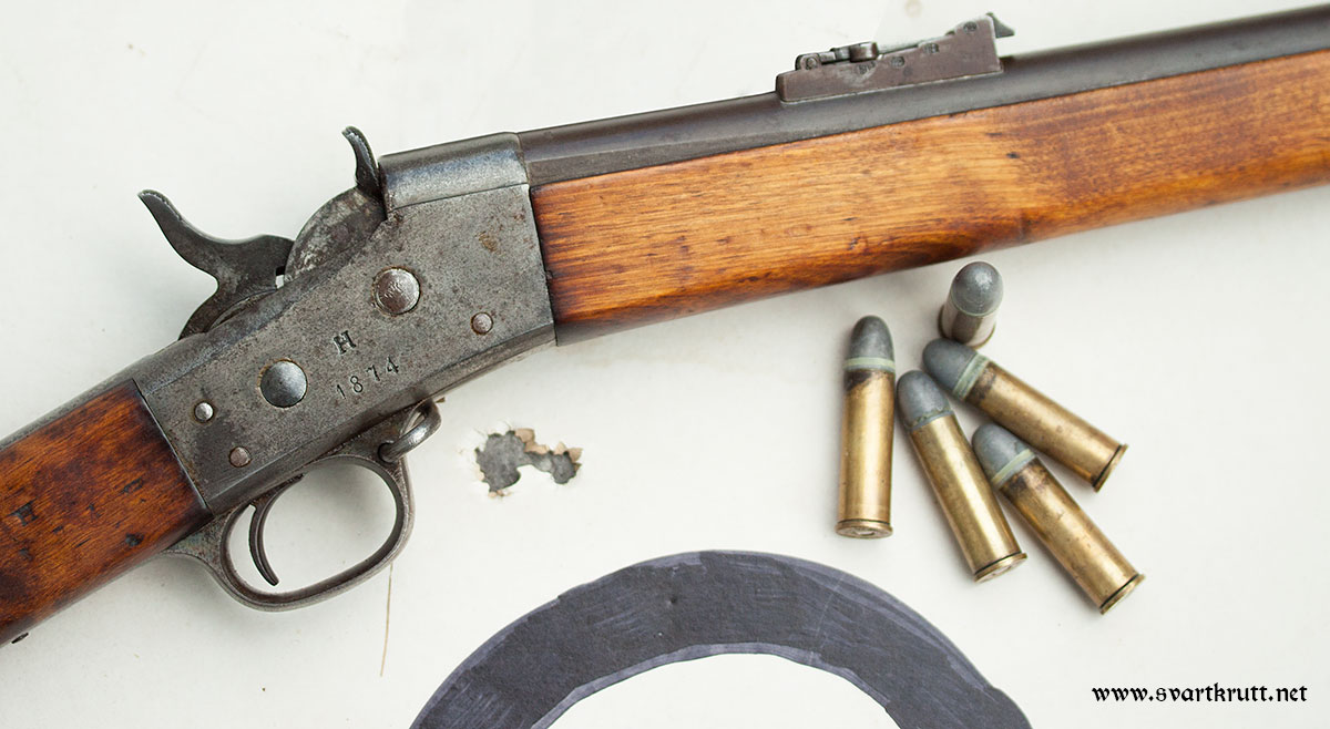

The Norwegian military rimfire cartridge case was 42mm to begin with but was later enlarged to 44mm after a new bullet was introduced in 1871. The Swedish cases were shorter, about 40.7mm, but the ammunition was interchangeable in the rifles of the joint kingdoms of Sweden and Norway.
Original military 12mm Remington ammunition. From left to right: Case for blank cartridge, Norwegian cartridge with 44mm long case and four Swedish cartridges with 40.7mm cases.
When the rifles were sold on the civilian market in the beginning of the 20th century, the breech block was converted from rimfire to centrefire. While the rimfire cases could not be reloaded, the centrefire cases could be used numerous times. Read the article about the civilian use of the Norwegian rifles.
On the civilian market the calibre is best known as the 12 × 44, 12 × 44, 12,7 × 44, 12,7 × 42 or just 12mm Remington. The Swedish cartridge is often designated 12 × 42, based on the incorrect assumption that the Swedish case was 42mm long while it in fact was only 40.7mm. Civilian cases were – as far as it is known – only made in 44mm lengths.

Strictly speaking, you do not need a reloading press and die set to reload Remington cartridges. But if you want to use reloading tools, some companies, such as RCBS and CH4D, produce die sets for old Swedish and Norwegian Remington rifles. However, they are often incredibly expensive. A much cheaper solution is to use a die set for the .50-70 Government which in most cases works excellently.
Bertram Brass in Australia manufactures cases for 12 × 44, but the best option is to buy .50 Alaskan cases that you trim to correct length. You can also form cases from .348 Winchester.

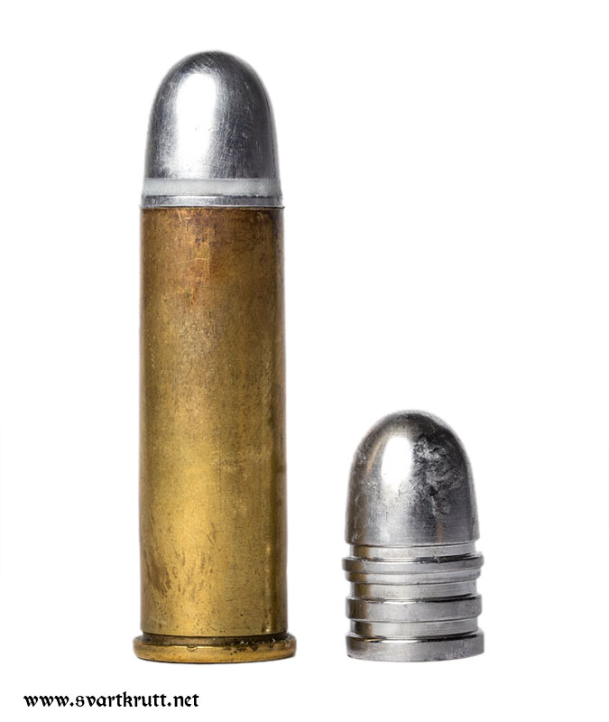

There are several bullet alternatives available: You can also use bullets for .50-70 Government sized down from anywhere from .512" to .505". svartkrutt.net has its own heel base bullet design based on various original bullets. These moulds were made by Lee Precision but are currently not available.
The svartkrutt.net heel-base bullet.

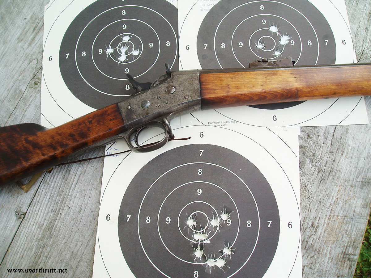

An exceptionally tight seven shot group shot from the bench at 100m (109 yards). The load used was 58 grains of Wano PP, a bee's wax wad and the Jämttången heel-base bullet.

Test of different loads at 50m (55 yards).
Skiver på 50 meter
Testing the svartkrutt.net bullet at 50 metres.
Skive på 100 meter
Testing the svartkrutt.net bullet at 100 metres.
