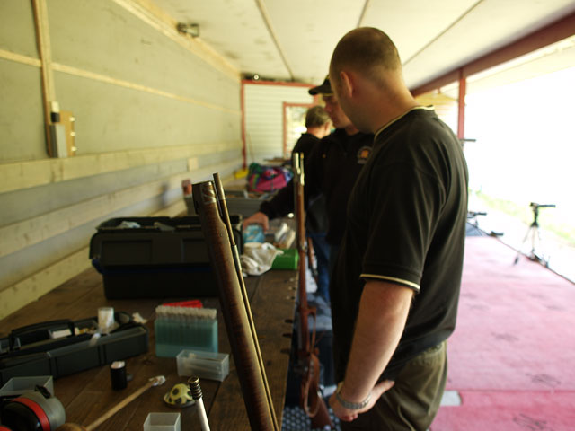

Deathwind still works the way she is supposed to. This year I took her to the annual Norwegian Championships in July. The outcome was a silver medal in the Maximilian replica class. This event is shot from the prone position at 100 metres. The score wasn’t very good at all. 79 point is in my opinion pretty bad and I had expected a score closer to 85. I’m still satisfied as I didn’t wear any modern shooting clothes, I didn’t use peep sights nor did I use a sling as many of the others did. Per Østby won by the way, and he broke the 12 year old national record in this class.
I didn’t have much time to practise before the championships due to my studies but managed to get off a few shots before I headed east. My front sight was way too tall for shooting at 100 metres, and I spend a lot of time filing it down. As a matter of fact I wasn’t satisfied until the day before I left for the championships. The charge and components I used is as follows:

Picture from the range at the Norwegian Championships. Deathwind in the foreground and the owner telling lies to Sverre Kvalø which used his Pedersoli Mauser in the Minié class.
