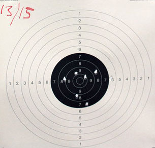

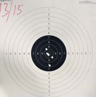

by Øyvind F. ⌂ @, Bergen, Friday, May 04, 2012, 20:21 (384 days ago) @ Hunter
It would be interesting if you post the results here when you get to try one of the cylinders. Here's one of my targets from the Nordic Championships in 2010 in Orivesi, Finland. We shoot 13 shots at 25 metres at two targets and the best 10 is counting. I think I ended up with 92 points and a bronze in this one. Same load as mentioned above, with T/C Bore Butter over the chamber mouths.
[image]
There are six shots on the target (X-X-X-9-9-8). Unfortunately, I messed up on the second :knegge:
[image]
