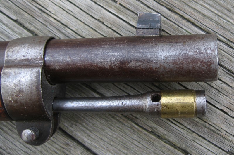

On my rifle I made a new front sight with a slot for the existing blade and soft soldered it onto the excisting.
Came out like this:
[image]
