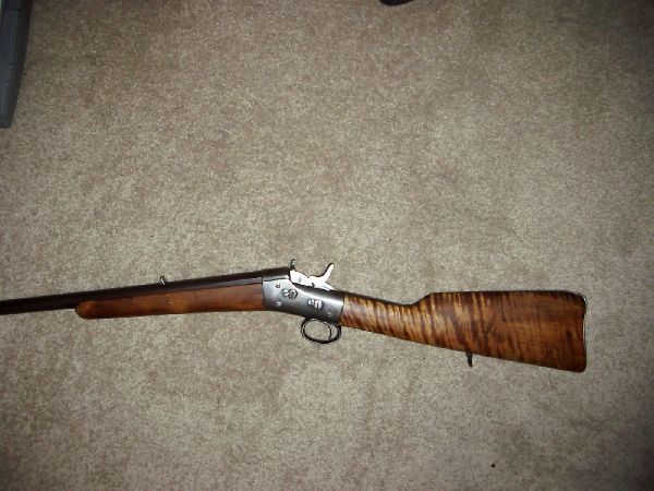

I have slugged the barrel & it comes out between .513" & .515". The approximate diameter of the chamber cast is just under 14mm, with a rim dia of 16mm.
The buttplate, inside of the triggerguard, forend & stock are all stamped with the number 4649. The frame is stamped with a crowned C. The barrel carries the different number 3497 on the side flat, but this is very feint. The barrel also carries the number 1870 on the underside. There is also a crowned C on top of the barrel. with the letters GA to the left of the C & WN to the right.
I have also attached a picture as requested.

According to your measurements you have a 12 mm Remington. :)
The crowned C indicates that the rifle is made up from discarded military parts from Carl Gustaf Stads Gevärsfaktori (gevärsfaktori = arms factory). As far as I can remember this factory only made about 300 civilian rifles. However, the different numbering on your rifle suggests that it is made up from military parts.
You can either use fireformed .348 Win. cases or buy brass directly from Bertram brass. Your rifle should be a good shooter.
